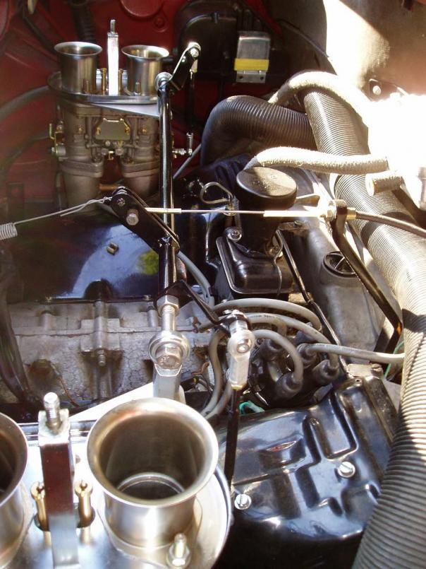

> need some pics of carb linkage, installing new engine need pic of throttle cable

installing new engine with carbs, had a 1.8, I need some ideas on where/ how you may have mounted (anchored) your throttle cable, thanks

QUOTE(Phoenix 914-6GT @ Jun 1 2008, 08:51 PM) *
What is that bent box wrench looking thing? That looks great!

rhodyguy   that cable bracket is incuded in the Triad linkage...   Jun 1 2008, 11:07 PM

mattp   I have the linkage set up from Raby, that box wren...   Jun 2 2008, 09:45 AM
Vacca Rabite   I rigged up a very simple (and strong) system. I ...   Jun 2 2008, 10:17 AM
Vacca Rabite   Found them. This is what I made. Ken (Zymirgist)...   Jun 2 2008, 10:31 AM

Gint   The CB Performance linkage set works just fine for...   Jun 2 2008, 12:06 PM

mattp   how do you attach the linkage to the carbs? Also ...   Jun 3 2008, 10:10 PM
rhodyguy   use the hole in the pass side engine tin that is p...   Jun 4 2008, 09:32 AM
Kargeek   CB Linkage- Homemade bracket made with a hacksaw. ...   Jun 4 2008, 10:56 AM
96740   CB Linkage- Homemade bracket made with a hacksaw....   Jun 4 2008, 08:47 PM
anderssj   CB linkage with home-made throttle bracket--always...   Jun 4 2008, 08:22 PM
