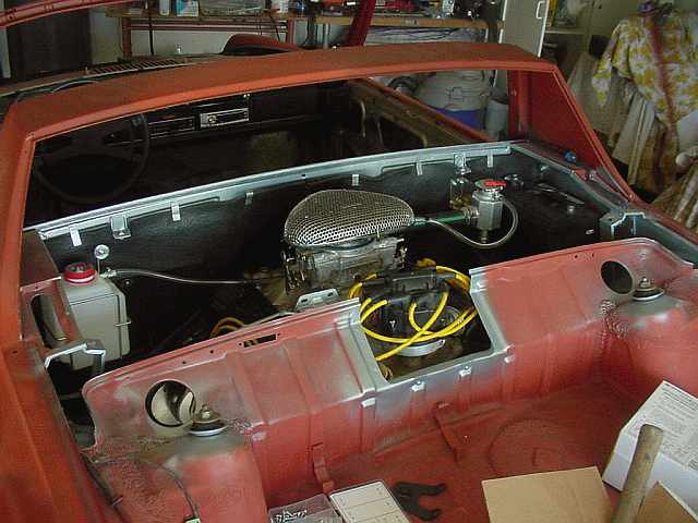

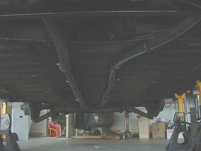

After cooking breakfast and some family time...I headed for the garage. Today I ran all the coolant lines under the car, hung the coolant resevoir can, a overflow jug, installed the gas tank and put the front end stuff back together.
I going to need some help on the cutting of the front bumper. I have a very nice early bumper with good chrome...will a plasma cutter cut an opening without screwing up the bumper? I want to put somekind of grill in the opening?? I see renegade offers a spoiler, still looking for options.
I will also need to either cut or buy a dual opening rear valance. OK...enough babble, here's some pics.

computers4kids   More progress...installed exhaust, prepped the fro...   Jun 1 2008, 10:04 AM
computers4kids   After cooking breakfast and some family time...I h...   Jun 2 2008, 12:45 AM
computers4kids   radiator lines & front trunk compartment (gas ...   Jun 2 2008, 12:46 AM
