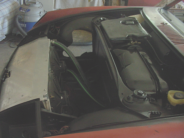

radiator lines & front trunk compartment (gas tank, etc)
computers4kids   Installing a V-8...a few questions   May 28 2008, 10:21 AM
michaelt55   Mark; Heres a photo of my radiator setup... I hav...   May 28 2008, 10:50 AM
andys   Mark, If your stock headers have heat shields, I ...   May 28 2008, 10:55 AM
plymouth37   When I worked at Renegade I used rivets to attac...   May 28 2008, 11:06 AM
marks914   Here is how I did my front trunk. Why did I move m...   May 28 2008, 12:00 PM

plymouth37   Here is my front end. With Renegades lower valence...   May 29 2008, 11:48 AM
