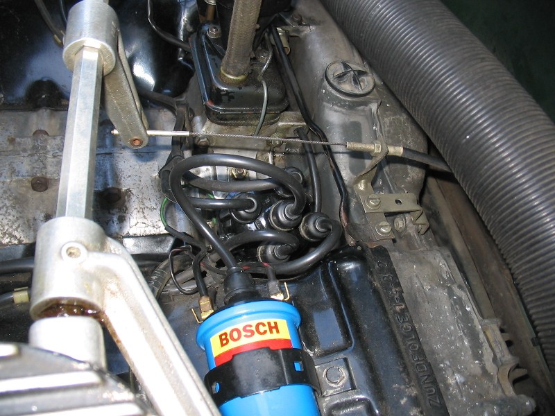

installing new engine with carbs, had a 1.8, I need some ideas on where/ how you may have mounted (anchored) your throttle cable, thanks

CB linkage with home-made throttle bracket--always intended to go with something prettier but it has lasted like this since around 1982 (IMG:style_emoticons/default/dry.gif)

rhodyguy   that cable bracket is incuded in the Triad linkage...   Jun 1 2008, 11:07 PM

mattp   I have the linkage set up from Raby, that box wren...   Jun 2 2008, 09:45 AM
Vacca Rabite   I rigged up a very simple (and strong) system. I ...   Jun 2 2008, 10:17 AM
Vacca Rabite   Found them. This is what I made. Ken (Zymirgist)...   Jun 2 2008, 10:31 AM

mattp   how do you attach the linkage to the carbs? Also ...   Jun 3 2008, 10:10 PM
rhodyguy   use the hole in the pass side engine tin that is p...   Jun 4 2008, 09:32 AM
