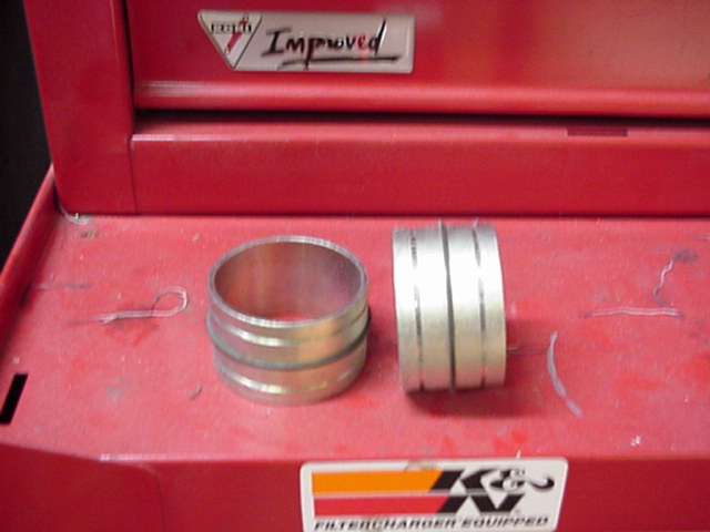

I think I have a 1" rear spacer on the bottom of my spring. I would like to take it out to make my car have less rake. My question is how much camber change will 1 in of lowering make? Thanks

I have a set of the spacers Brad was talking about, I'll sell 'em for 5 bucks plus shipping.

Eddie Williams   I have a set of the spacers Brad was talking about...   Jan 1 2004, 10:56 PM
Brad Roberts   Those spacers are actually for the Koni's. The...   Jan 1 2004, 10:59 PM
