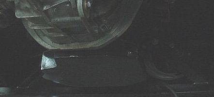

computers4kids   Well, I came home tonight after work and felt like...   May 29 2008, 11:38 PM
jmmotorsports   Well, I came home tonight after work and felt lik...   May 30 2008, 08:51 AM

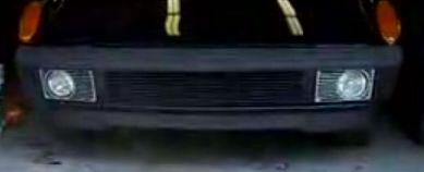

computers4kids   A little more progress... I took...no, "I dro...   Aug 1 2008, 06:12 PM
computers4kids   After the muffler shop, drove it down to this high...   Aug 1 2008, 06:38 PM
JRust   Sounds good Mark! Dual tips fill it perfectly....   Aug 2 2008, 12:30 AM
