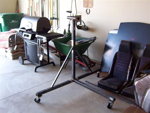

Started on the rotisserie today. One side is done and other on the way. As I'm back dating the bumpers does anyone have the info for it? I know I saw something awhile back on it but cant find it. Here's some pics.

Luke M   Started on the rotisserie today. One side is done ...   Jun 6 2008, 04:08 PM

Brando   If you're worried about stress on the longs......   Jun 6 2008, 07:02 PM
Luke M   I have the Engman stiffening kit installed. I...   Jun 6 2008, 08:04 PM

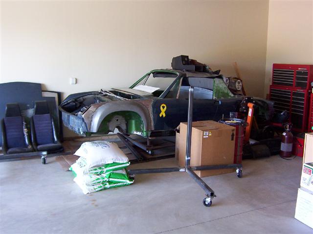

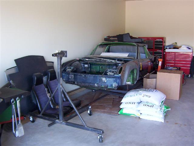

Luke M   Finished the rotisserie and mounted the 914 to it....   Jun 10 2008, 09:20 AM
