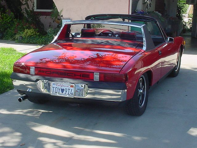

Edited.....thought I would add some before and a after picture since this thread has evolved into a v-8 install/restore/modify thread. The story begins....
