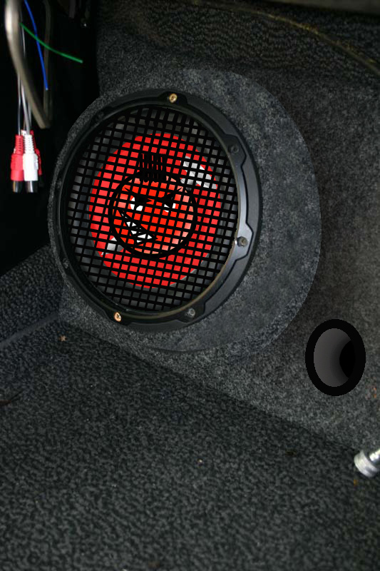

I just got my new subwoofer enclosure from James, but have a question.
Who has one, and how did you secure it in the footwell?
Btw, I highly recommend it if you're wanting bigger sounds in the car... (IMG:style_emoticons/default/smile.gif)
