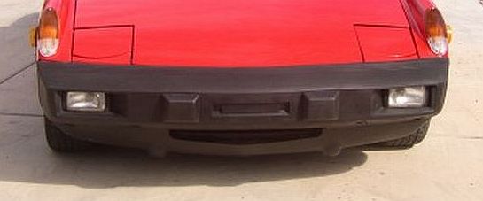

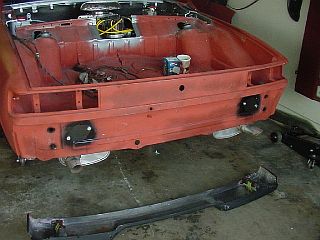

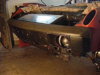

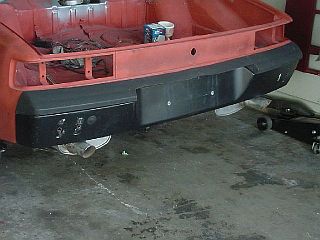

A little more progress today...the focus was bumper updates or should I say "bumper backdate."
I drilled the appropriate holes for the early bumpers (front and rear). I drilled and mounted early fog lights. Using Engman's late bumper block-offs (another great member product) I capped the late bumper shock holes. The engman block-off plates were designed for the fronts, but I made them work on the back holels has well. I then mounted my 74 bumpers on the car to check for fit...yes. When I get around to it...I'll pull the bumpers back off and weld-up the titty holes. Got luck today...everything went right.
The front bumper still also needs to be modified for air flow...haven't decided what kind of opening I want to make...or the size of the opening. I've been looking and there's quite a variety out there. I'm really not sure how small I can go and still have efficient cooling here in the hot valley. (IMG:style_emoticons/default/idea.gif)
I really like the last picture's breather opening...but looks pretty small compared to others.
