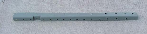

More work on the tunnel for welding porn fans. Bottom edges of the tunnel
where it meets the floor were rusted out. Made some L shaped patches to
bridge this gap. I have made 3 of the 5 needed to complete this repair. Here
is patch number 3.

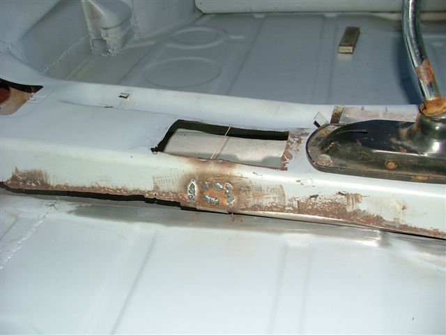

Clamped the patch in place.

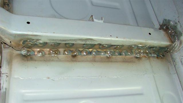

Plug welded through the holes. Some welds turned out smooth and flat and
some turn into big globs metal that are a pain to grind down. All were prepared
the same way so there is something to this art that eludes me still. I noticed
that using higher voltage tends to make welds that lay flat, while lower voltage
tends to make high, globby welds.
One more gap on the side of the tunnel to go.
