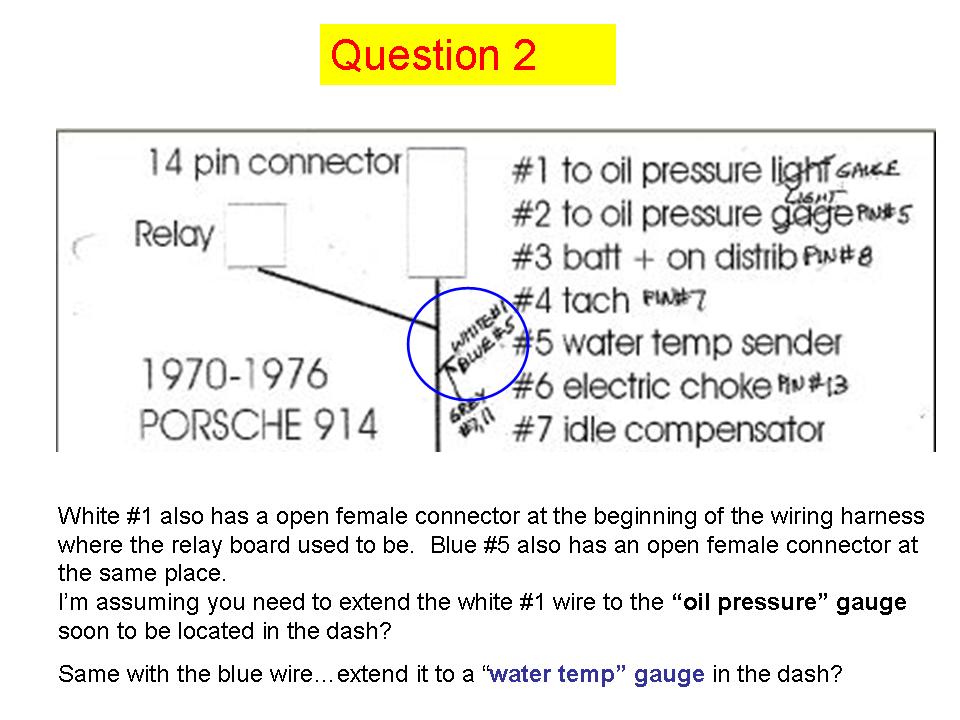

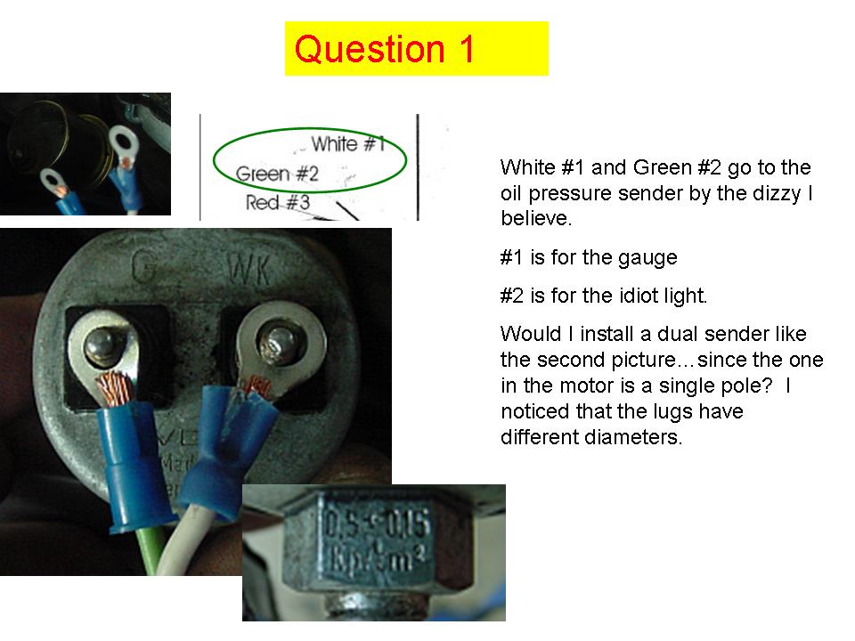

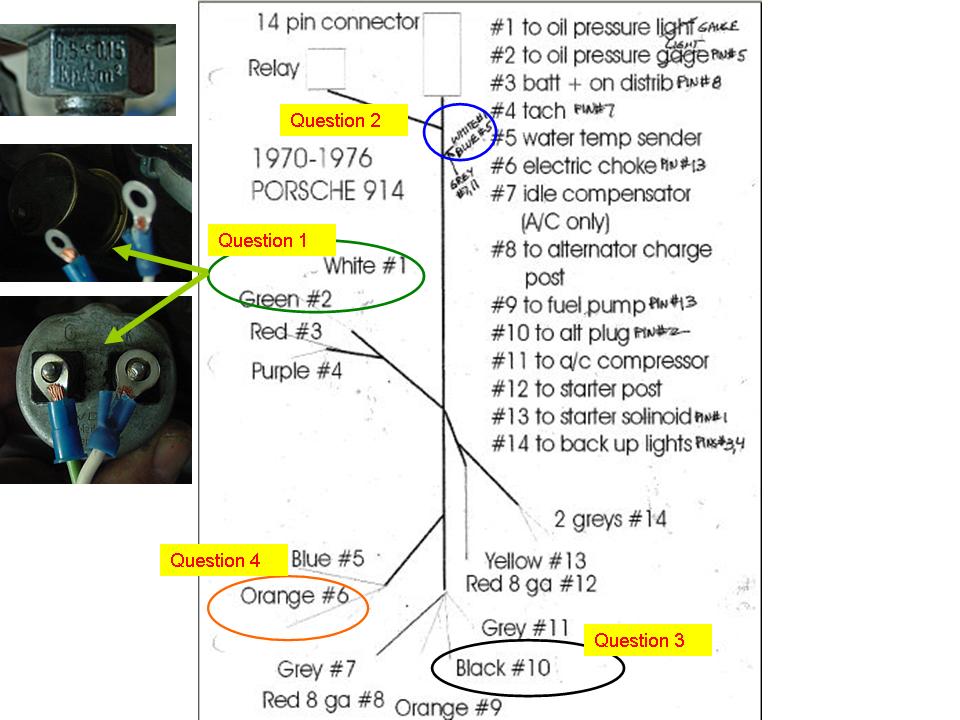

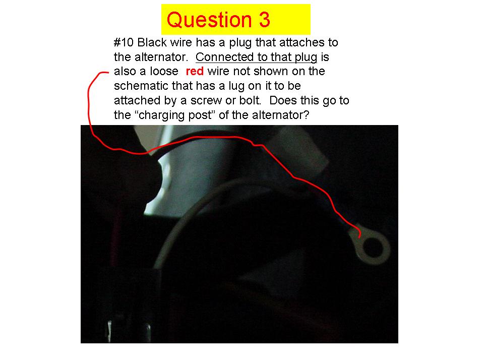

Today I started installing the Renegade wiring harness that came with the kit. Wiring is not my strong suit and I have four questons. The firs picture is an overview of the wiring harness and where the questions are located. The following four pictures each represent one of the questions. Hopefully this makes sense...

computers4kids   Today I started installing the Renegade wiring har...   Jun 11 2008, 10:23 PM
computers4kids   last question   Jun 11 2008, 10:23 PM

Dr. Roger   <What do you think...am I on the right track?...   Jun 21 2008, 10:13 PM
Dr. Roger   applicable thread... http://www.914world.com/bbs2...   Jun 21 2008, 10:18 PM
computers4kids   applicable thread... http://www.914world.com/bbs...   Jun 22 2008, 12:14 AM
