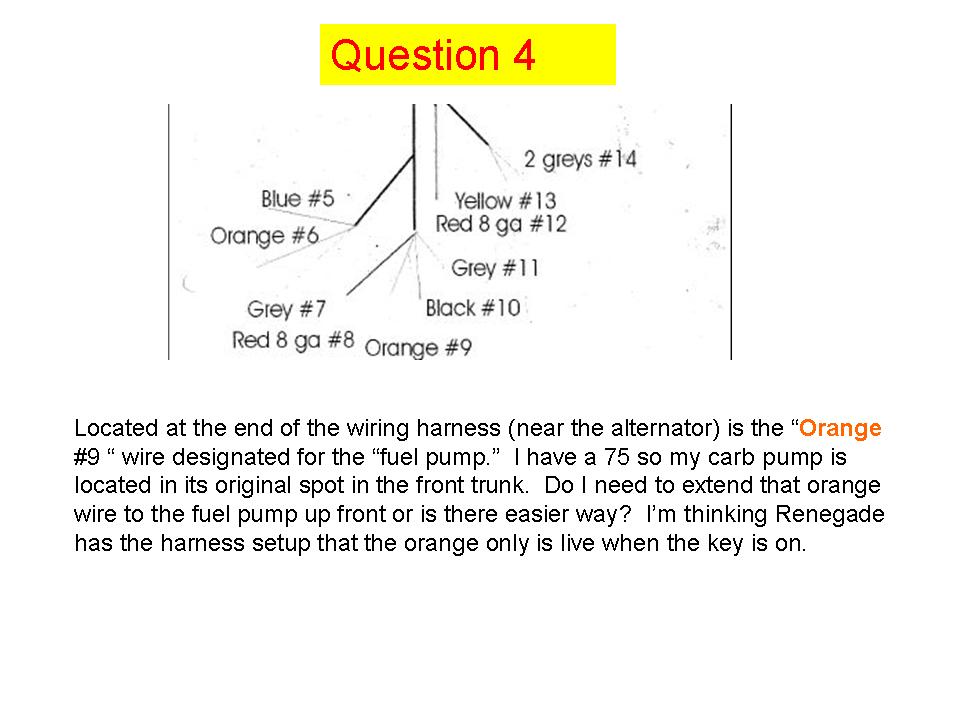

I'm installing a chevy 305 with a renegage kit and I have a few questions.
There seems to be plenty of room to leave the battery tray in the OEM position, why do many move the location to the trunk?
I have the Renegade wiring harness but no diagram...can someone send me a copy?
The exhaust is headers with twin turbo exhaust. Do you remove the stock exhaust heat sheild...it fits either way. Is it good to leave it or remove it?
Where do you source your power for the front 'dual fan radiator?' From what I have read it needs to be powered all the time, not switched. Is there a source to tap into in the front trunk or do you run a dedicated line...if so how heavy?
I would really love to see pictures of your V-8 914 front end so see what kind of setup you did for valance and cutting the bumper! I'm good on the fender cuts.
Stupid Question: The renegade recommends using #8 1/2 metal screws to attach the brackets that hold the coolant hoses to the bottom of the car. It mentions to be careful not to puncture the fuel lines in the tunnel. How can you tell if your'e going to hit a fuel line or not? ...other than just hoping and guessing?

computers4kids   Today I started installing the Renegade wiring har...   Jun 11 2008, 10:23 PM
