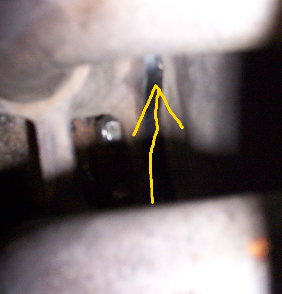

Sorry for the crappy pic, but the leak is right about there. There may be others, but that's all I can see. It's cylinder #3
