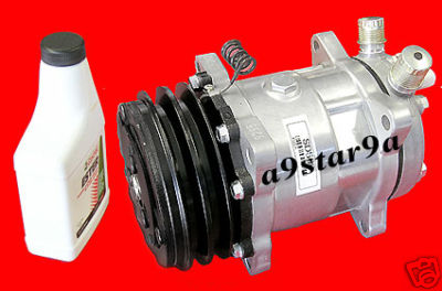

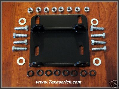

I bought a new Sanden508 off an ebay auction that runs on R134 and a new adapter plate that is made specially to bolt the 508 to the York bracket. Cost for the two with shipping was $200.
Now that I've gone to a v-8, I'm not to sure I will be using the parts.

computers4kids   I bought a new Sanden508 off an ebay auction that ...   Jun 12 2008, 08:36 PM

maf914   The adapter bracket in Computers4kids post is avai...   Jun 18 2008, 09:52 AM
computers4kids   The adapter bracket in Computers4kids post is ava...   Jun 18 2008, 10:54 AM

thomasotten   Is this adapter all that is needed to bolt to the ...   Jul 30 2008, 01:24 PM
computers4kids   Is this adapter all that is needed to bolt to the...   Jul 30 2008, 01:37 PM
