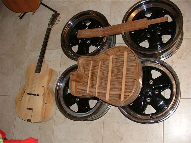

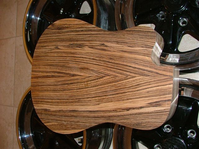

Here's what I was working on before 914 fever hit.
The archtop was made from a sign off an old building that was torn down.
The other is the body of a bookmatched zebrawood accoustic. Zebrawood
is a real pain to resaw and bend, but it looks great and is harder than
rosewood. It would make a resonator so biting and bluesy it would
make the sun cry and the moon howl. (IMG:style_emoticons/default/happy11.gif) If only I had time...
Aaaaaa, it wouldn't be very traditional anyway...
