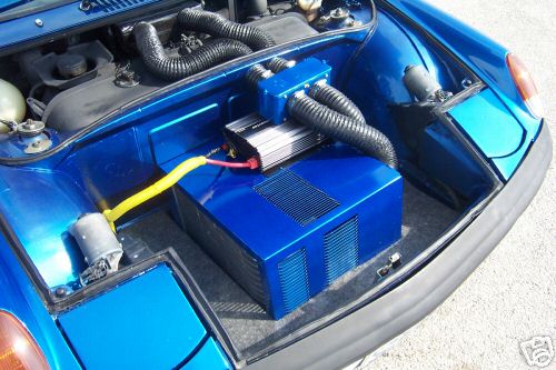

There's always option "B" (IMG:style_emoticons/default/smile.gif)

QUOTE(LvSteveH @ Jun 12 2008, 07:30 PM) *
What is that Steve?!?!
LvSteveH
post Jun 18 2008, 12:24 AM
I put the Poor in Porsche
Posts: 1,080
Joined: 22-April 03
From: Las Vegas, Nevada
Member No.: 600
QUOTE(Gint @ Jun 17 2008, 04:27 PM) *
McMark nailed it. I simile whenever I see that pic.

McMark   A more helpful parts store might have a picture/sp...   Jun 12 2008, 07:56 PM

McMark   Power Inverter + home A/C unit.   Jun 17 2008, 08:01 PM
