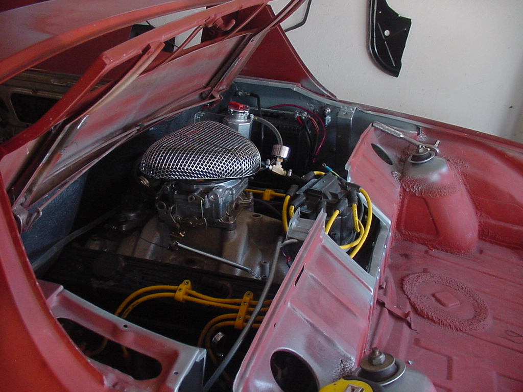

The latest...
I removed the support brace from the engine lid and slotted the brackets for easy on/off installation. I also had to trim the ring part of the air cleaner to bring the air cleaner down just a tad. It all fits nicely when I close the lid.

computers4kids   The latest... I removed the support brace from the...   Jun 18 2008, 08:53 AM
computers4kids   In the engine compartment I added a wide mesh stee...   Jun 18 2008, 08:55 AM
