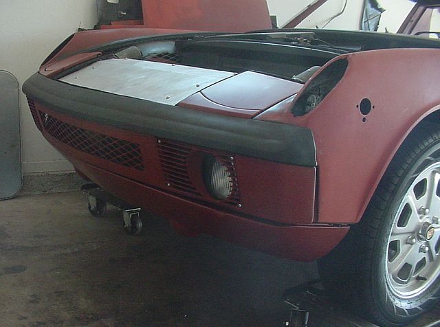

Edited.....thought I would add some before and a after picture since this thread has evolved into a v-8 install/restore/modify thread. The story begins....

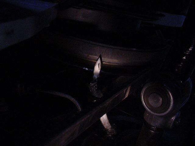

The car can now be timed from the driver's wheel well.
How:
Using the driver's side heater cable tube which is no longer used in the conversion I bent it up and toward the engine balancer. I then took a white screw ancor and ground the end down so it would fit in the end of the heater tube with the pointed end right next to and in front of the balancer. I then found TDC and placed some white paint at the end of my new timing pointer representing when the engine is at TDC on the compression stroke. Now, using my adjustable timing, I can dial in a curve and point on the underside of the driver's fender well and time the engine. Actually works pretty good.
Went ahead and adjusted initial timing without vaccumm advance to 9 degrees at 850 rpm. The engine actually is running and starting pretty good.

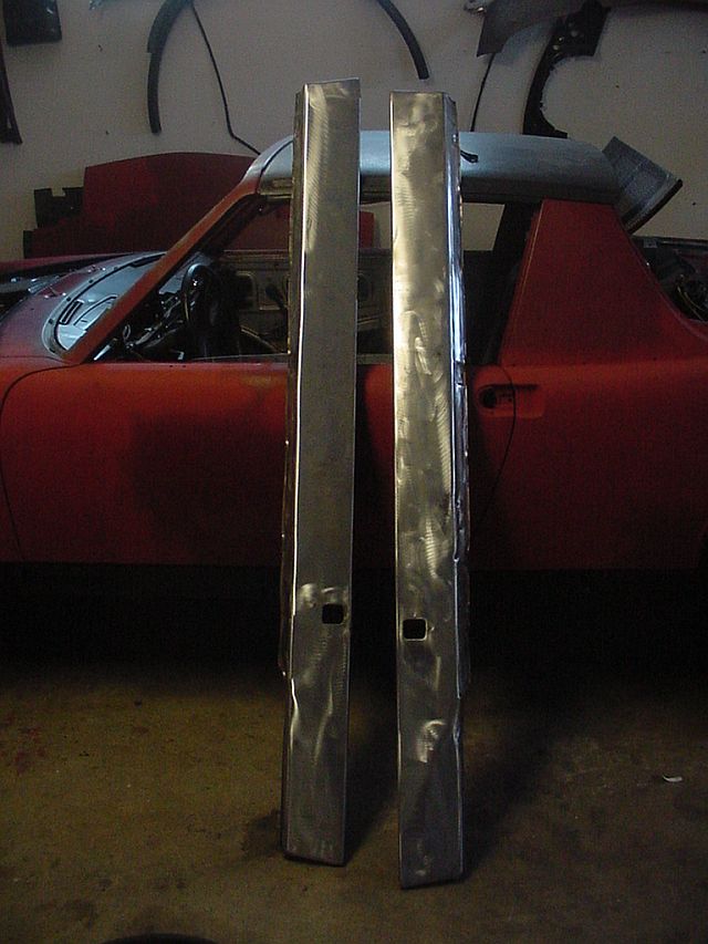

This weekend, I also stripped the side rockers and the front valance, did any body work necessary and primed them...went ahead and fitted the front spoiler to make sure all fit correctly...I had updated from 75 bumpers.
