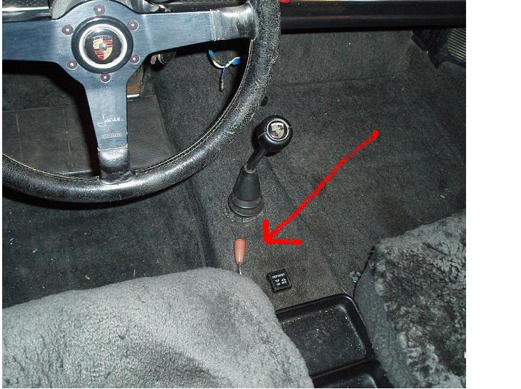

I put the engine and transmission back in car but transmission is in gear regardless of shifter?
How can I make sure shifter and transmission are in sync without starting car? (new engine need to break it in) Thanks, Matt |

I put the engine and transmission back in car but transmission is in gear regardless of shifter? How can I make sure shifter and transmission are in sync without starting car? (new engine need to break it in) Thanks, Matt Disconnect shifter near the shifter and put the tranny in neutral at the tranny |

I put the engine and transmission back in car but transmission is in gear regardless of shifter? How can I make sure shifter and transmission are in sync without starting car? (new engine need to break it in) Thanks, Matt Disconnect shifter near the shifter and put the tranny in neutral at the tranny you'll see the disconnect shifter thing under the carpet at the red arrow. Attached image(s)

rhodyguy you mean to say you can't engage any of the ge... Jun 28 2008, 12:11 AM
mattp the car is in gear, I dont know which one (other t... Jun 28 2008, 09:29 AM
rhodyguy try moving the coupler on the bottom of the shift ... Jun 28 2008, 09:37 AM
mattp I'm sorry, I do not understand you. Let me tak... Jun 28 2008, 10:01 AM![]() ![]() |
