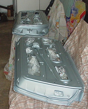

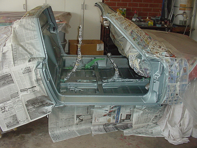

Today, I painted the interior "marathon blue" along with the inside of the doors. I went with single stage on the inside. The outside will be going the same color but base coat, clear coat.
Now I can start putting the interior back in now...acutally looks like its coming together.
