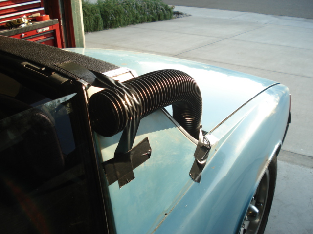

post Jul 1 2008, 09:40 PM
Posts: 1,849
Joined: 29-October 05
From: tracy,ca
Member No.: 5,022
Here's a pic. of what I added to get air into the bay. I love it!! I think I will stick with this one! (IMG:style_emoticons/default/biggrin.gif)
The tubing only covers about half of the hole on the side of the engine bay lid.
The CHT's where a bit cooler than without them. The one thing I did notice is that, while a freeway speeds they seem to stay a bit more stable.
Where I normally see temps. of 365 I saw temps about 357-360.
Also the intake air temps where lower by about 3-4 degrees.
So for the most part, I think it makes a bit of a difference and is worth pursuing.
