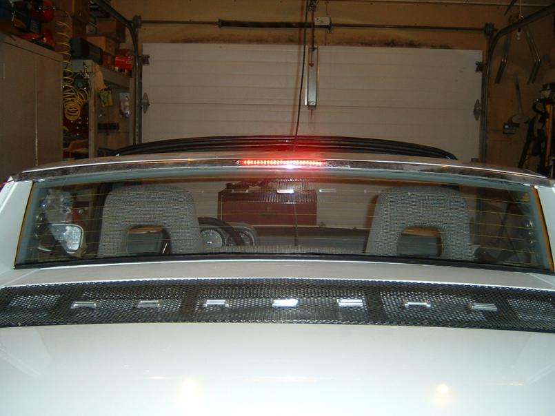

I bought a LED universal brake light on Ebay for about $8. I bought as short a light as I could get.(24 LED's and about 7 1/2" long) I took it apart and determined that it could fit into my roll bar trim. Since I just bought a parts car I felt I had an extra roll bar trim to experiment with...so I did. The trim will be painted black so it should blend in even better.
I've yet to mount it on the car, it will be tight but I think I can make it work.
Either way, for $8 it was worth the dream of a nice high mounted brake light.

tracks914   Just an update. I installed the light on my car. I...   Jun 19 2008, 05:27 PM

tracks914   Nobody noticed the seats??? (and the gray interior...   Jun 19 2008, 09:19 PM
Travis Neff   I noticed the seats, what are they out of?   Jun 20 2008, 06:04 PM
tracks914   88 Corolla.   Jul 2 2008, 12:11 PM
6freak   88 Corolla. letters on the engine lid appear to...   Jul 2 2008, 01:20 PM
Travis Neff   88 Corolla. Tease..........   Jul 2 2008, 01:58 PM
seanery   looks great! more pics of the interior?   Jul 2 2008, 11:13 PM
tracks914   Soon to come as a new thread.   Jul 4 2008, 06:49 AM
