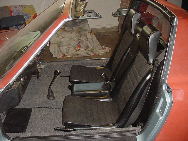

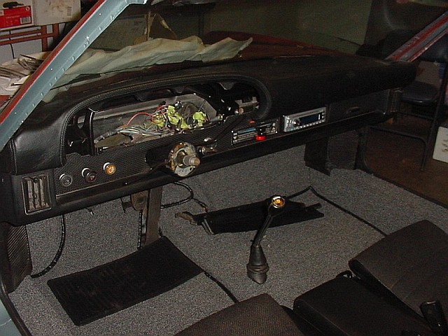

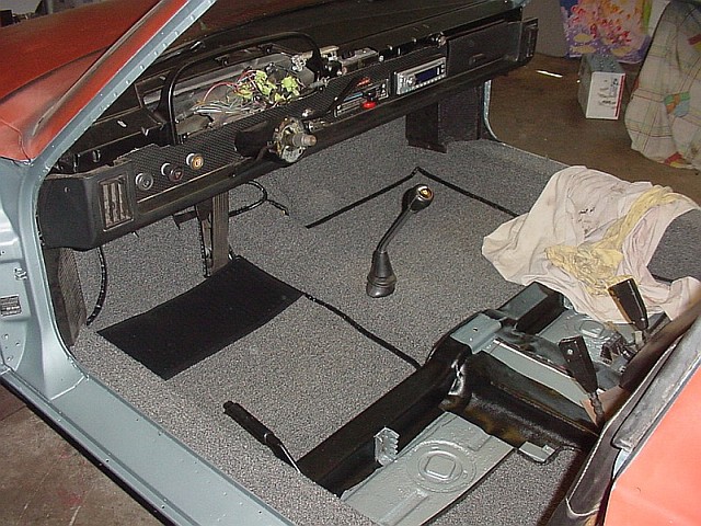

I've begun installing the interior of the car. And as usual, the targa rear pad was a pita--getting the two 10mm latch bolts and the little screws for hold the bracket plates back on was a joy.
Installed...
rear window, backpad, carpet, seats, seat belts and various interior pieces. I also got started on the Ghetty dash. Gauges should be here right after the holiday (July 4th).
Lots still to do...all that little stuff sure eats-up time. The hardest part for this project is finding all the correct bolts and screws. When I bought this car the interior had already been torn out and many parts missing. I'm finally to a point now that I actually know what parts need to be acquired.
