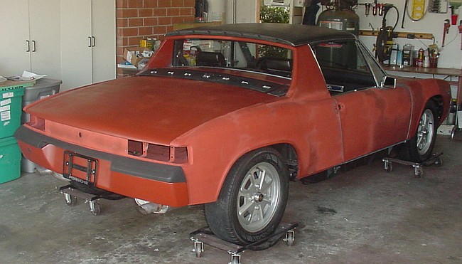

Edited.....thought I would add some before and a after picture since this thread has evolved into a v-8 install/restore/modify thread. The story begins....

Doors went back on today...alignment was a piece of cake thanks to the club tip of drilling a small hole in the hinge through the body before pulling the doors.
Interior is just about done. The dash is the big one left and then add a windshield seal.
Looks like I may have to make my own rear valance...really wanted the wide early one found on 70 and 71 cars...of course I'll have to do some alteration to the oem hole and add another.
