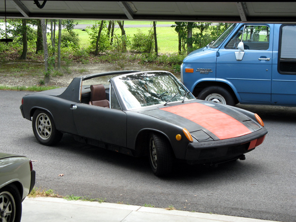

i wanted a v8 ever since seeing a piece about rod simpson back when i was a kid. my car was a $1500 ebay buy with some rust and other needs. probably best to stick with jake for the more original cars - but feel free to cut that baby up if it has no chance ever of winning a concours event : ))
hey - who the hell stuffed that v8 into my ride : ))
