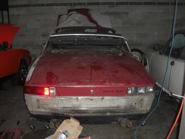

I've got a rear valance that would work. It is on my 74 2.0 car. I'll add the picture I have. You can have it free if you come & take it off (IMG:style_emoticons/default/biggrin.gif) It is some aftermarket valance but is in great shape. Not the best picture of it but I can take more if you want.
Huh (IMG:style_emoticons/default/idea.gif) Come to WCR & get a free Valance. I do really need that to finish my car (IMG:style_emoticons/default/idea.gif) I guess I will have to go after all (IMG:style_emoticons/default/happy11.gif)

QUOTE(JRust @ Jul 4 2008, 12:49 AM) *
OK (IMG:style_emoticons/default/driving.gif)

JRust   I've got a rear valance that would work. It is...   Jul 4 2008, 01:49 AM
computers4kids   I've got a rear valance that would work. It i...   Jul 4 2008, 12:30 PM
type47fan   Lookin' good, Mark. I modified a '72 vala...   Jul 5 2008, 12:30 AM
