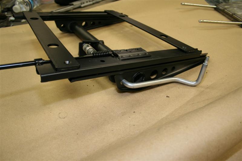

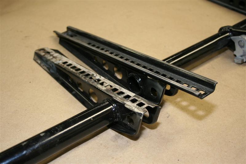

If you want to make your seats function even better, cut off the OEM seat sliders and use 911 ball bearing sliders. It lowers the seat and the seats slide REALLY easy. Metal to metal sliders just can't compare to ball bearings. I have short legs and I slide my seat back every time I get out of the car so this really helped. A few pics...
