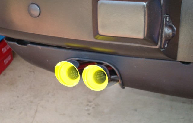

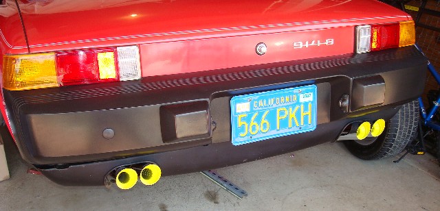

computers4kids   A little more progress... I took...no, "I dro...   Aug 1 2008, 06:12 PM
computers4kids   After the muffler shop, drove it down to this high...   Aug 1 2008, 06:38 PM
JRust   Sounds good Mark! Dual tips fill it perfectly....   Aug 2 2008, 12:30 AM
