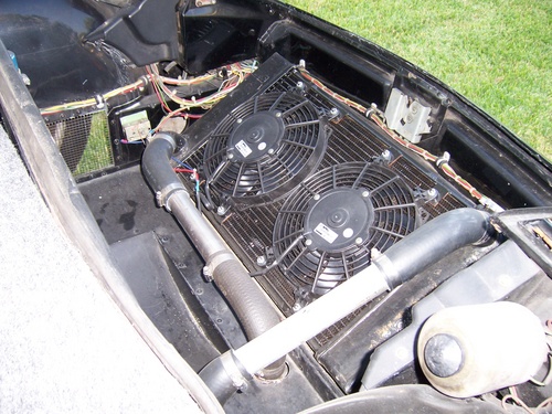

This seems to work well for me...its easy to modify to.... the fans run either single or in tandem....I have no problems...EXCEPT when I have air in the system...

michaelt55   This seems to work well for me...its easy to modif...   Jul 6 2008, 09:16 AM
marks914   Yours breathes from the front, the other one seems...   Jul 6 2008, 10:01 AM
JRust   Was there a particular radiator you got? Or did yo...   Jul 6 2008, 07:18 PM
michaelt55   Was there a particular radiator you got? Or did y...   Jul 7 2008, 10:50 AM
