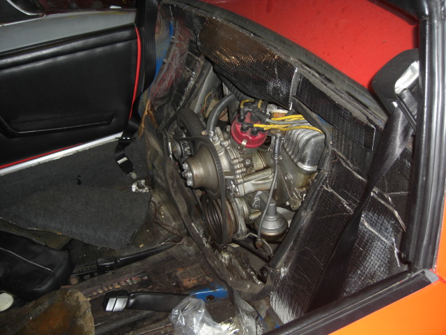

One other question. My buick 215 v8 comes thru my firewall quite a bit. Would running an electric water pump save me much room up front? Also are they very effective?

It saves the room that pump sticks forward, minus the length of some elbows you will have to incorporate with the timing cover. I have a Meziere remote mount 55gpm water pump and it works fine.
http://www.meziere.com/ps-1150-1118-wp337s.aspx
holy crap, they have rocketed in price! Anyway, you want the higher flow and don't want the 30-33gpm pumps like CSI and so forth. Understand that the stock water pump will flow a small amount at idle but a fair amount at higher rpm.
And that thing protrudes a LOT. Many of the V8 kits set the trans back a bit or have a custom trans mount or adapter to move it back a couple inches. I suspect they installed that at stock trans location...
