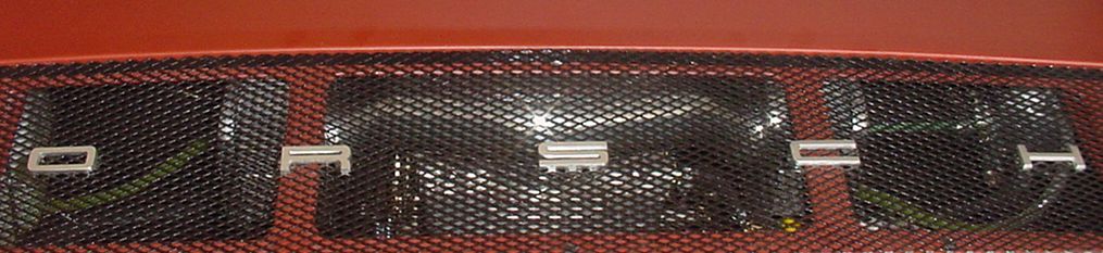

I'm also toying with the idea of making my lid into a double grill...still not sure. The lid already is quite a bit more flimsy without the center support...can't imagine what it would be like if I altered the other side. (IMG:style_emoticons/default/idea.gif)

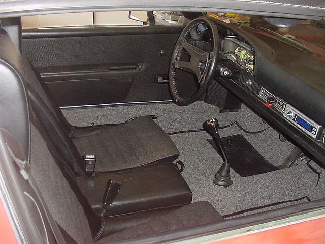

computers4kids   More progress... Today, I painted the interior ...   Jun 29 2008, 11:38 PM
computers4kids   I've begun installing the interior of the car....   Jul 2 2008, 11:21 PM

computers4kids   Let's see... Installed the rest of interior li...   Jul 7 2008, 06:18 PM

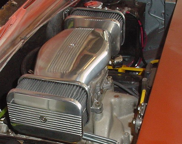

computers4kids   Well, took a couple of weeks off and travled up to...   Jul 18 2008, 09:34 PM
JRust   I kind of like the flatter & wider ovaled pipe...   Jul 19 2008, 02:17 PM
computers4kids   Installing the ghetty dash took much longer than I...   Jul 20 2008, 09:40 PM
JRust   Yes just pull the cover & loosen the one bolt....   Jul 20 2008, 09:59 PM
