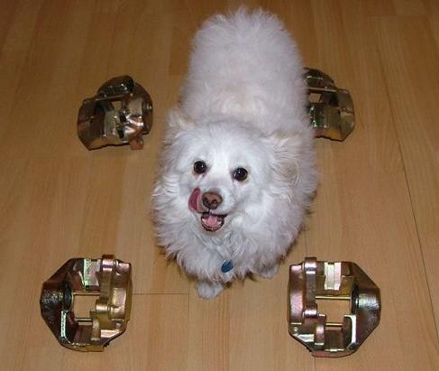

Got some rebuilt calipers recently from Eric Shea.
MMMM, tasty!!!
Eric's calipers are a thing of beauty and very reasonably priced, although
there is a $100 core charge per foo foo dog.
John
