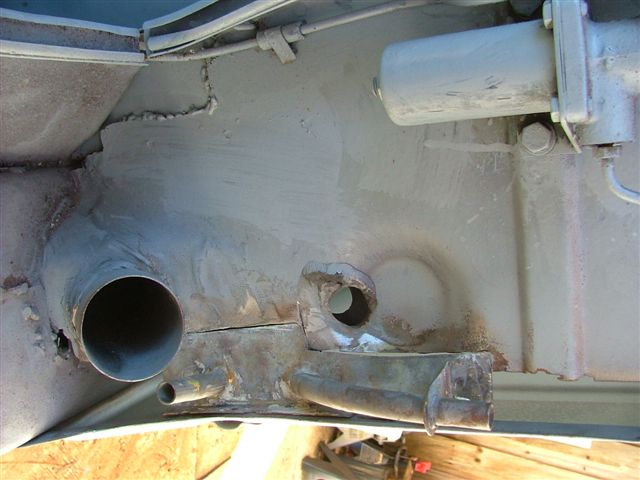

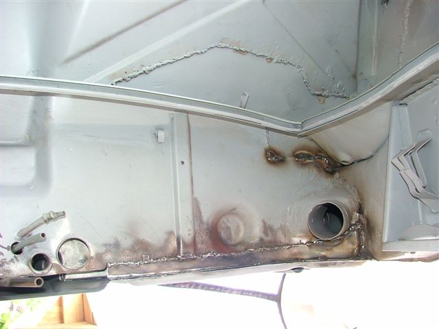

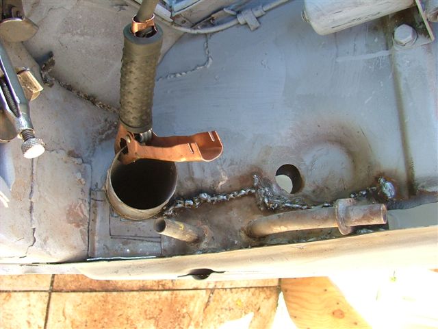

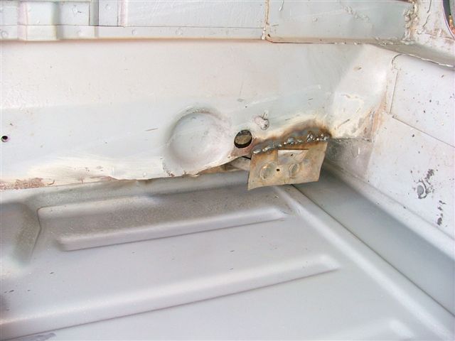

Closing up the firewall. I salvaged the e-brake tubes from an old firewall by
cutting out some sheet metal around them on the inside and outside walls.
Here is the inside section.
Did a hideous job of welding the outer piece in. Not sure why the welds came
out so badly. Also made a small patch for the left side.
Made a patch for the passenger firewall section.
These welds turned out better. It ended up taking 9 separate patches
to complete close up the inside and outside of the firewall and the result
would make Mary Shelley proud.
This is definitely a case where I would have been better off just buying the inner
and outer repro pieces from Auto Atlanta. The hassle of drilling out all the spot
welds to get the fragements of the old crap out would have been less than all the
careful cutting and fitting I had to do for a look that will never pass for factory.
The more I work on this, the more I want the sheet metal repairs to be close
to original.
