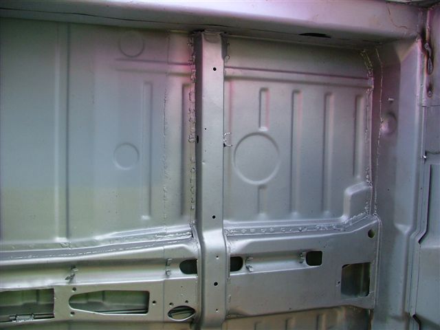

Inside of the firewall.
Firewall and tunnel sprayed with Eastwood silver rust encapsulator.
Almost done with the chassis work. Then its on to cosmetic sheet
metal. (IMG:style_emoticons/default/mad.gif) The last post not withstanding I am tempted to make this
thing into a rat rod and spray matte black primer over the rest of
the rust and holes and be done with it... (IMG:style_emoticons/default/happy11.gif)
