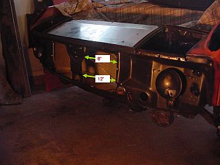

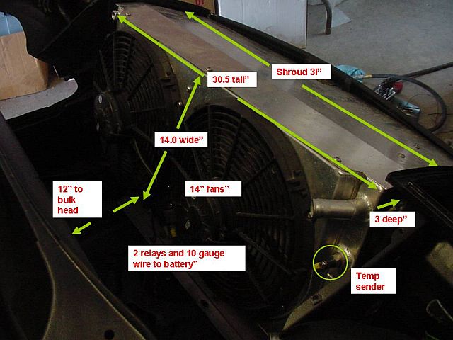

Some dimensions to think about

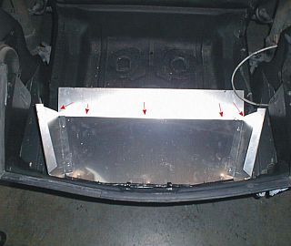

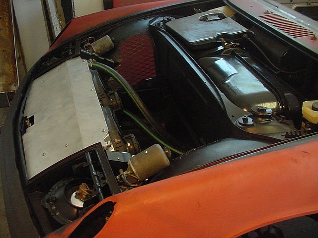

michaelt55   This seems to work well for me...its easy to modif...   Jul 6 2008, 09:16 AM
marks914   Yours breathes from the front, the other one seems...   Jul 6 2008, 10:01 AM

computers4kids   Jamie, I can't remember... Is the gauge that y...   Jul 7 2008, 09:20 PM
computers4kids   Jamie, a plasma cutter would be nice since they wo...   Jul 7 2008, 08:55 AM
JRust   Jamie, a plasma cutter would be nice since they w...   Jul 7 2008, 10:09 AM
JRust   Sweet! I was going to have you measure your ra...   Jul 8 2008, 12:26 AM
byndbad914   If I don't have luck with finding a radiator...   Jul 8 2008, 02:57 PM
computers4kids   Some dimensions to think about   Jul 8 2008, 07:57 AM
