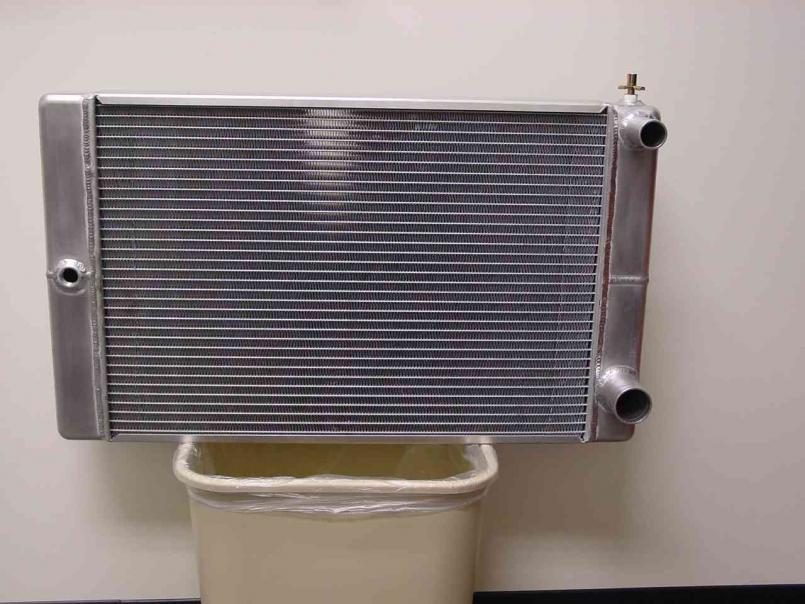

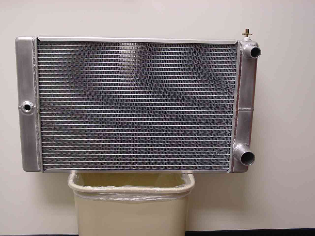

I am using an AFCO #80133N aluminum dual pass ASA racing radiator (with cap delete) for my V8 conversion. Though you'll have to fabricate the mounting and ducting, the radiator was only $229 two years ago.
