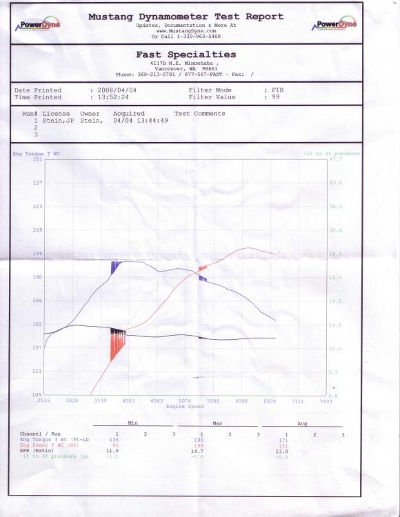

Solex or E cams are the cat's ass for a street/AX car.
S cams (& up) ain't worth spit with carbs unless it's a race car spending it's time above 5K rpms. Street cars spend 80% of their time on the idle jets.
Here's a chassis dyno graph of my 2.7L with Solex cams.
