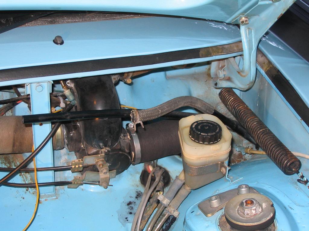

Well I decided to pull the tank after finding out there is no filter up front( pump has been moved up front) and seeing very bad fuel lines up front. Good thing I did, the filter sock was shot to say the least. The area under the tank is in fairly good shap with a few spots of rust and alot of dirt and grime. The rust is not structural which is good.
I am not sure if this is the first time the tank has been out or not. It is amazing what you will find in the area under the tank besides dirt, grime, and rust.(razor blades, paper towels, washer nozzle, snap-on tool, sanding disk, ect. ect.)
Suprisingly the inside of the tank is pretty clean. The outside has a few areas of light rust which I will clean up and paint.
So instead of replacing the filter it will be a little more involved. (While your in there syndrome)
My plan is to clean the area under the tank with oil eater, and give it a hot water bath, use some mar-hyde to convert the rust and then paint everthing.
This will be my first experience trying to git rid of rust and also painting. I hope it turns out good. Stay tuned for updates and pictures as I progress along.

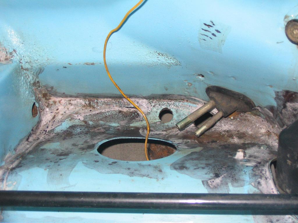

Another picture of the area under the tank.
Also replaced the outer fresh air tubes that were bad.

Tom   While you are in there, (ha,ha) you might check ou...   Jun 17 2008, 11:09 PM

Root_Werks   Under your gas tank area doesn't look that bad...   Jun 18 2008, 08:02 AM
URY914   Have a close look at your tank where it meets that...   Jun 18 2008, 08:29 AM
rhodyguy   the exterior tank rust hasn't even pitted the ...   Jun 18 2008, 08:46 AM
ericread   the exterior tank rust hasn't even pitted the...   Jun 18 2008, 11:57 AM
kpfoten   Just took mine out last week! What a dirty mes...   Jun 18 2008, 10:09 AM
URY914   You can use anything you find for the rubber pad. ...   Jun 18 2008, 10:25 AM
rhodyguy   jack, check out the pump thread at club and post a...   Jun 18 2008, 10:30 AM

championgt1   Well it has been a little while since I have reall...   Jul 16 2008, 11:38 PM
championgt1   Another picture of the area under the tank. Al...   Jul 16 2008, 11:41 PM
championgt1   Been awhile but got a little more progress done to...   Aug 25 2008, 01:17 PM
6freak   Been awhile but got a little more progress done t...   Aug 25 2008, 01:42 PM
Phoenix 914-6GT   Yeah... it is supposed to be black ;) So are you...   Aug 25 2008, 01:45 PM
championgt1   Sway bar mounting points are good. Bushings are pr...   Aug 25 2008, 02:34 PM
championgt1   Sorry for the dumb question. Andy, what panel are ...   Aug 25 2008, 03:51 PM
Phoenix 914-6GT   The one at the very front of your car. There looks...   Aug 25 2008, 04:00 PM
championgt1   Thanks Jon. I see what you are talking about. Hit ...   Aug 25 2008, 04:21 PM
Phoenix 914-6GT   Very comon for that area on these cars. A 10 MPH c...   Aug 25 2008, 04:33 PM
