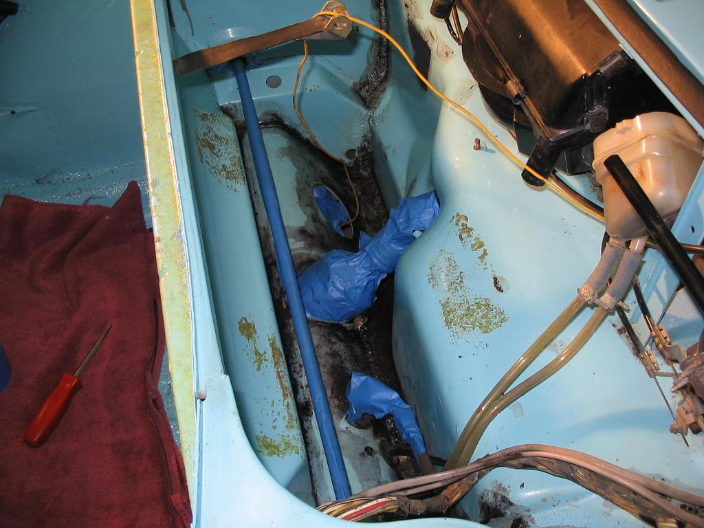

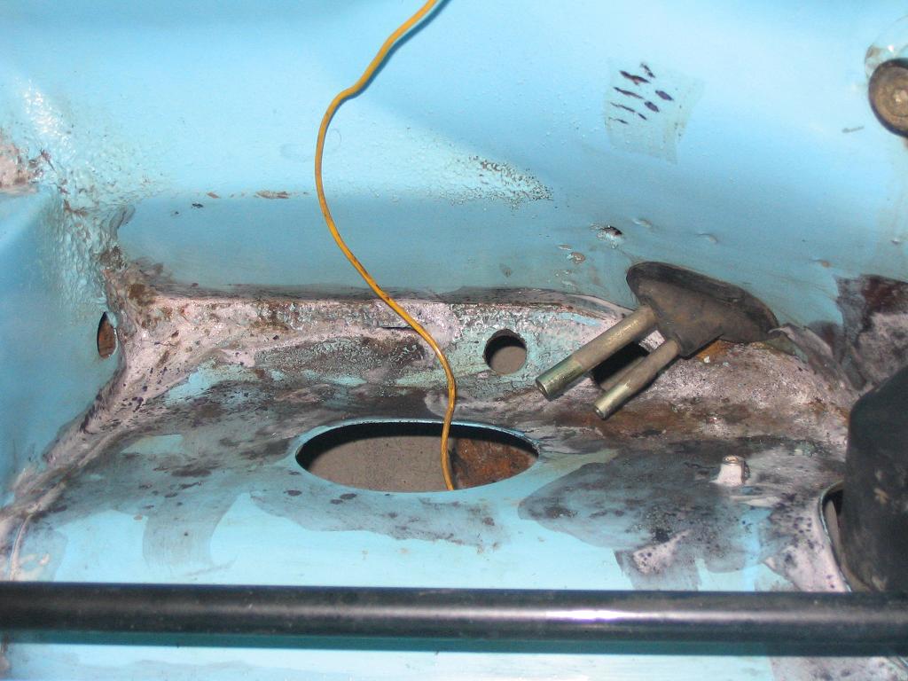

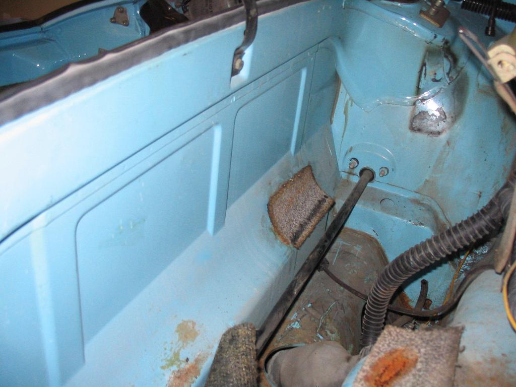

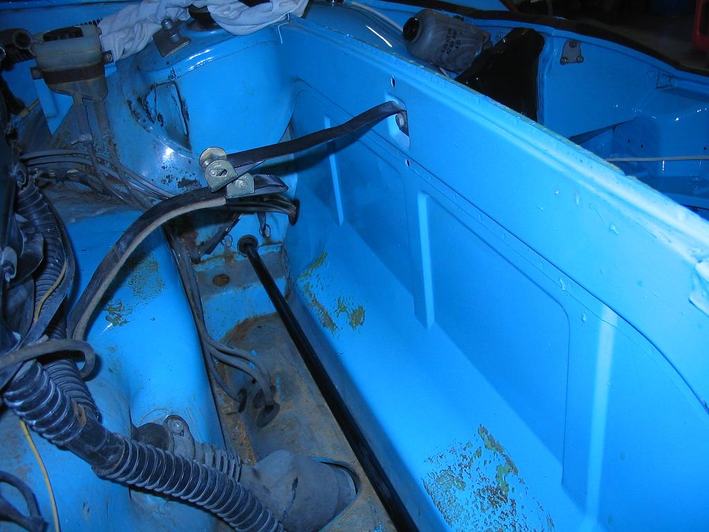

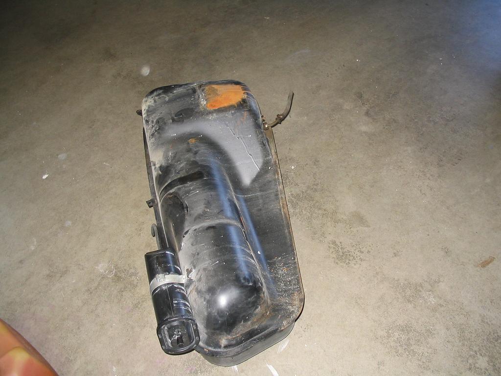

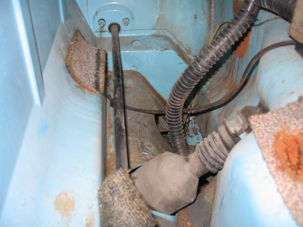

Well I decided to pull the tank after finding out there is no filter up front( pump has been moved up front) and seeing very bad fuel lines up front. Good thing I did, the filter sock was shot to say the least. The area under the tank is in fairly good shap with a few spots of rust and alot of dirt and grime. The rust is not structural which is good.
Click to view attachmentClick to view attachmentI am not sure if this is the first time the tank has been out or not. It is amazing what you will find in the area under the tank besides dirt, grime, and rust.(razor blades, paper towels, washer nozzle, snap-on tool, sanding disk, ect. ect.)
Suprisingly the inside of the tank is pretty clean. The outside has a few areas of light rust which I will clean up and paint.
Click to view attachmentSo instead of replacing the filter it will be a little more involved. (While your in there syndrome)
My plan is to clean the area under the tank with oil eater, and give it a hot water bath, use some mar-hyde to convert the rust and then paint everthing.
This will be my first experience trying to git rid of rust and also painting. I hope it turns out good. Stay tuned for updates and pictures as I progress along.

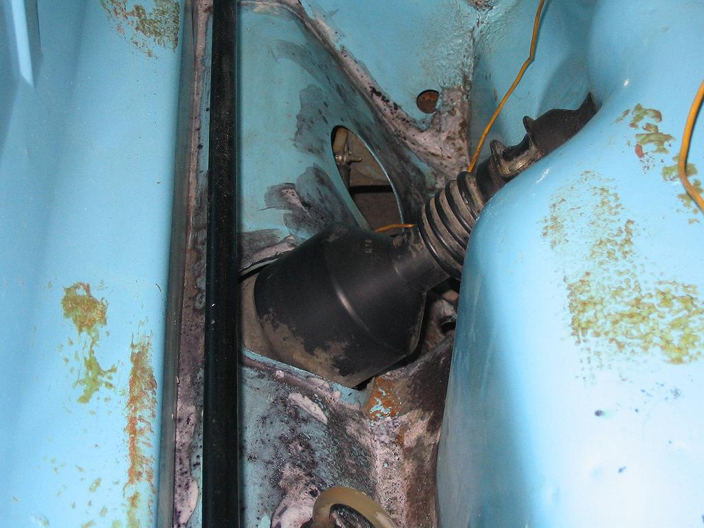

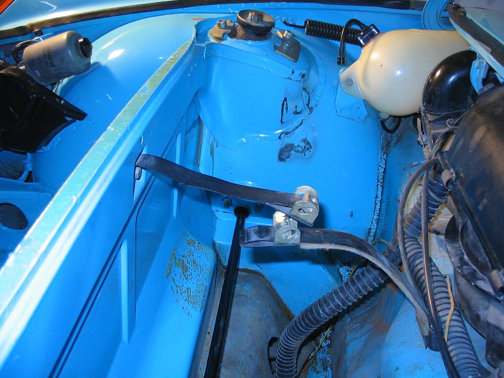

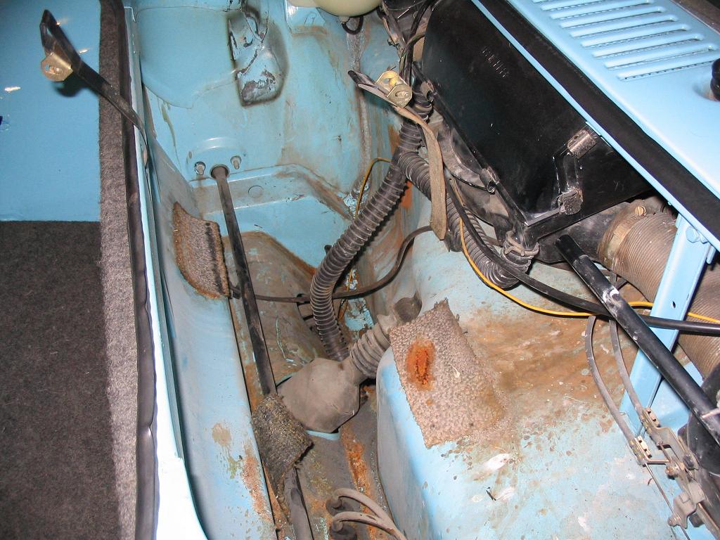

A few more pictures.
Click to view attachmentClick to view attachmentWhile I am up front I am also going to clean up the front trunk and paint some areas there as well.

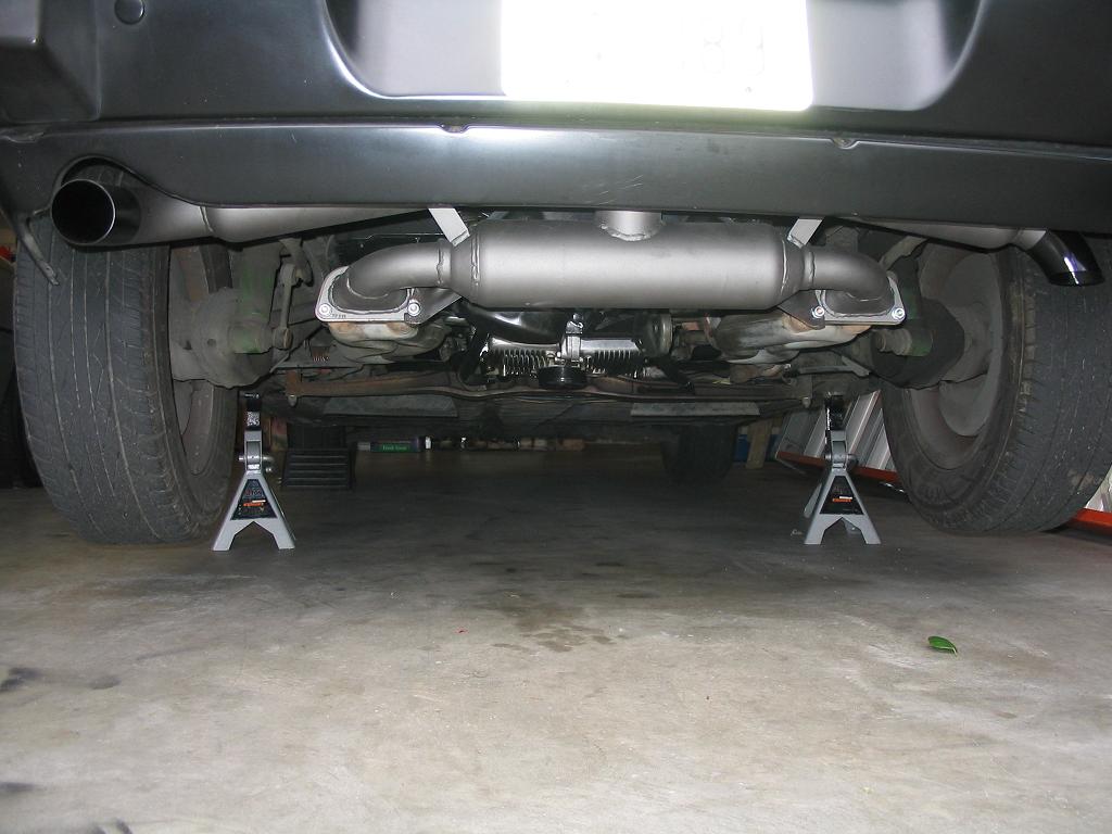

Thanks Jon. While I was contemplating taking out the tank I did manage to get my new Triad installed. Sounds like a million bucks even at just an idle. Can't wait to hear it at about 5000 rpm.
Tom
Jun 17 2008, 11:09 PM
While you are in there, (ha,ha) you might check out your cold air blower. I think the tank has to come out to get the blower out and I'm sure you will not want to pull the tank again anytime soon.
I need to get my blower out and I'm just putting it off till later. I know I will need to clean up the tank and tank area then also. Wish I had your energy right now.
Yep, them Triads do sound nice, don't they. Wife says too loud, what does she know?! I back dated my 76 with dave's sshe's and the Triad all at once. Lots of bucks, but the sound is soo nice.

Under your gas tank area doesn't look that bad at all. Clean, clean, clean and paint, assemble and drive!

Have a close look at your tank where it meets that felt pad on the driver's side. That rust stain looks bad. On my car the felt pad was wet and lead to a rust hole the same size as the pad.
Inspect your tank and remove the felt pad and replace with rubber.
rhodyguy
Jun 18 2008, 08:46 AM
the exterior tank rust hasn't even pitted the surface. more of a stain. debris accumulated inbetween the spot on the tank and the pass side of the well. jack's car would idle and die or not start at all until after a few minutes of the pump running. air bubbles were evident while cranking. no filter was installed after the tank outlet and prior to the pump. the screen looked as tho it had folded over because of being plugged when under suction. show the old tank screen jack. clean it up and let's put the tank in.

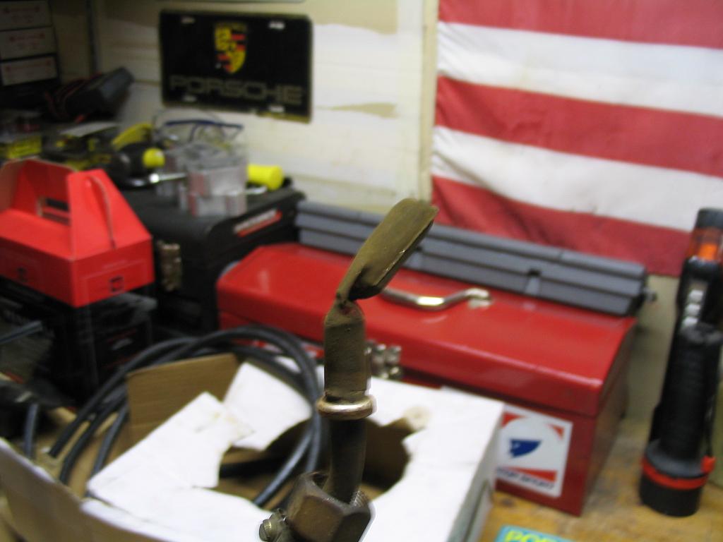

championgt1
Jun 18 2008, 12:22 PM
Here is a picture of the filter sock that came out of the tank. It has a tear at the bottom and you can see how it is collapsed. My thinking is that under suction it just sucks itself flat thus low or no fuel flow. We will see.

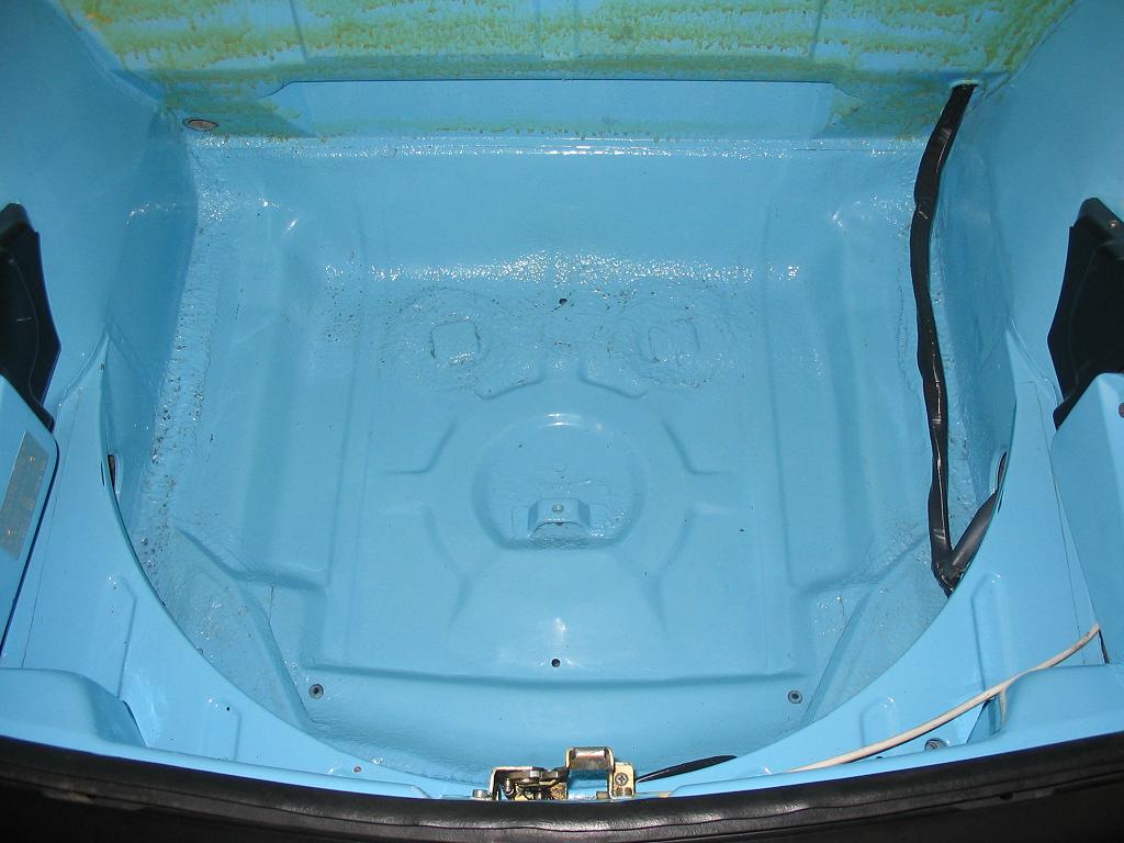

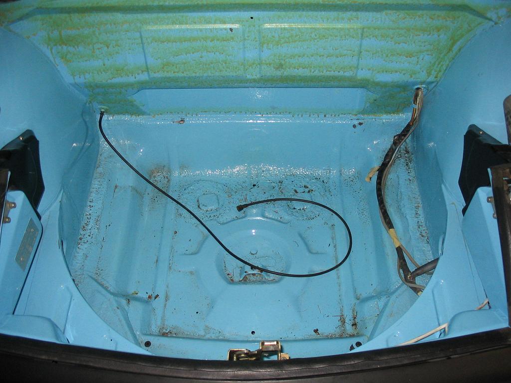

Spent about 2 hours tonight cleaning up the front trunk and area under the gas tank with some oil eater and a little elbow grease. Much more to do, but so far so good.
Click to view attachmentClick to view attachmentClick to view attachment
Jun 18 2008, 10:38 PM
take out your fresh air box and clean out the 30 years of leaves and pineneedles that have accumulated in there ...

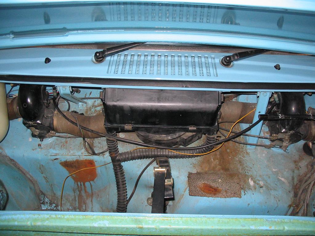

In this pic it looks like there are " rust trails" on either side of the air box from water leaks thru the windshield wiper bases. Mine has the same, does anyone else agree that's where it's coming from?

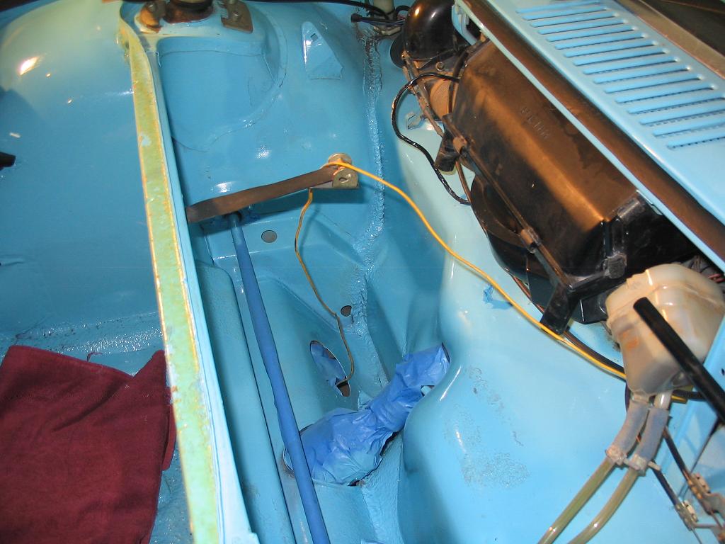

Well it has been a little while since I have really had an oppurtunity to work on my car. Got about 3 hours in tonight. Cleanup is done and all the rust areas have been given the Mar-Hyde treatment. Rust turns black, pretty cool.
Friday I am going to tape everything off and paint. Hopefully it turns out good.
A few pictures after cleanup and Mar-hyde.

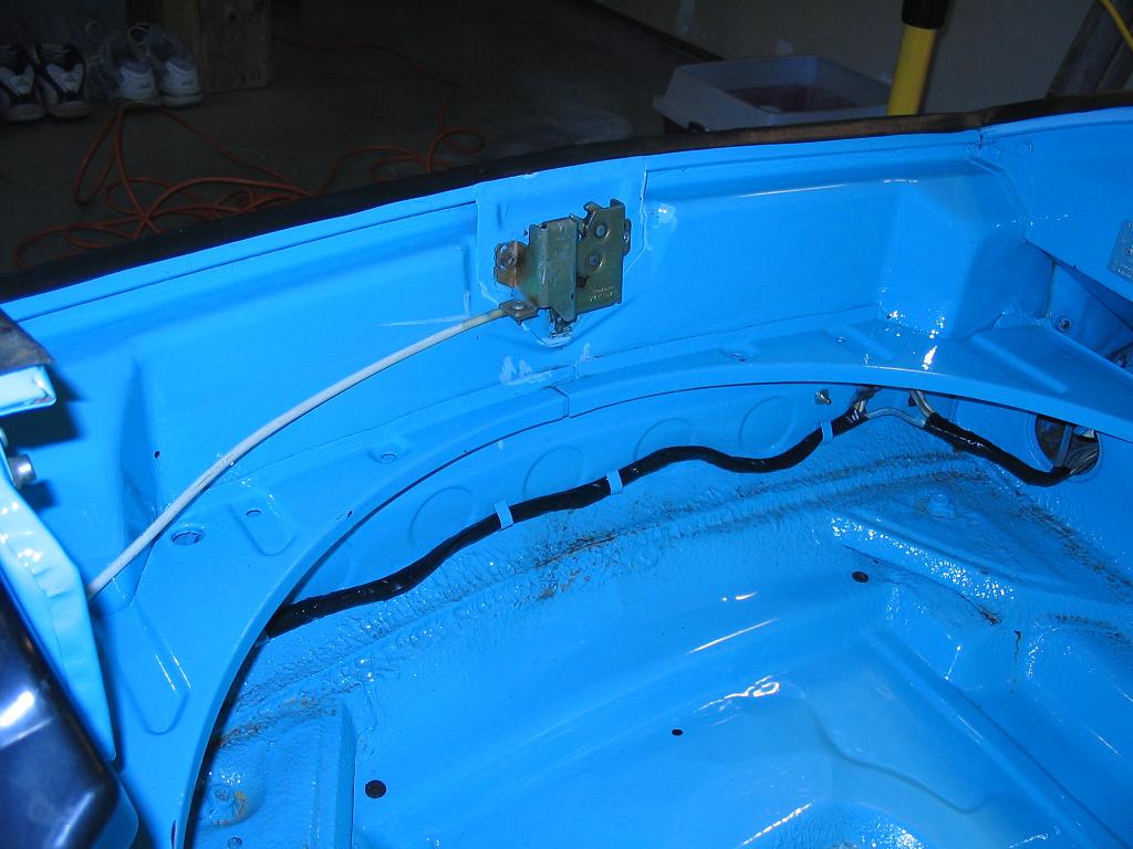

championgt1
Aug 25 2008, 01:17 PM
Been awhile but got a little more progress done today. Tapped off all the areas I did not want to paint. Put on a couple coats of paint. As soon as it dries the tank will go back in.
