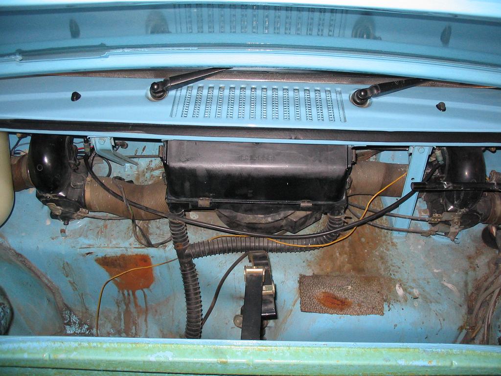

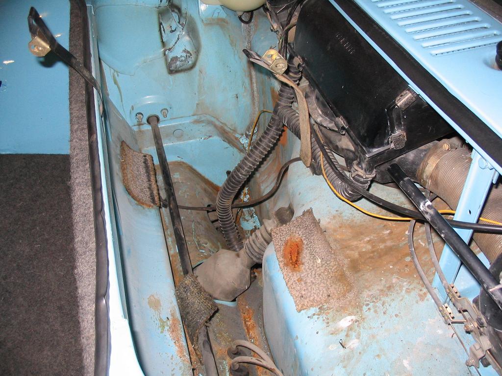

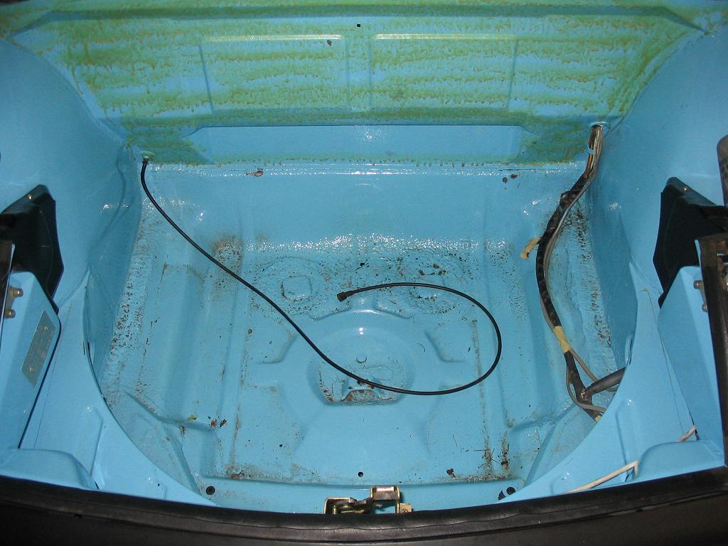

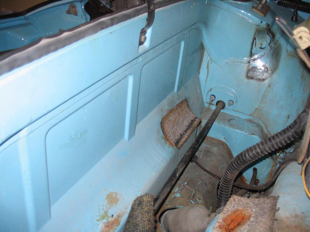

Well I decided to pull the tank after finding out there is no filter up front( pump has been moved up front) and seeing very bad fuel lines up front. Good thing I did, the filter sock was shot to say the least. The area under the tank is in fairly good shap with a few spots of rust and alot of dirt and grime. The rust is not structural which is good.
I am not sure if this is the first time the tank has been out or not. It is amazing what you will find in the area under the tank besides dirt, grime, and rust.(razor blades, paper towels, washer nozzle, snap-on tool, sanding disk, ect. ect.)

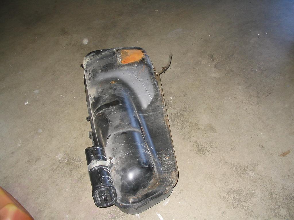

Suprisingly the inside of the tank is pretty clean. The outside has a few areas of light rust which I will clean up and paint.
So instead of replacing the filter it will be a little more involved. (While your in there syndrome)
My plan is to clean the area under the tank with oil eater, and give it a hot water bath, use some mar-hyde to convert the rust and then paint everthing.
This will be my first experience trying to git rid of rust and also painting. I hope it turns out good. Stay tuned for updates and pictures as I progress along.

A few more pictures.
While I am up front I am also going to clean up the front trunk and paint some areas there as well.

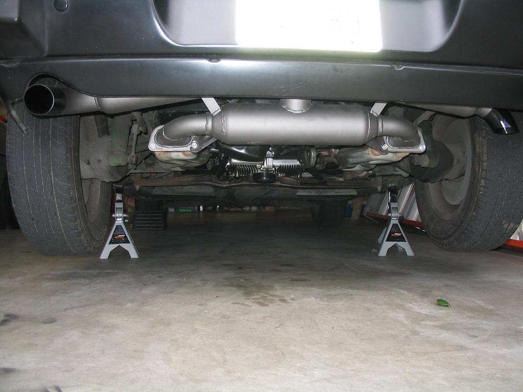

Thanks Jon. While I was contemplating taking out the tank I did manage to get my new Triad installed. Sounds like a million bucks even at just an idle. Can't wait to hear it at about 5000 rpm.

While you are in there, (ha,ha) you might check out your cold air blower. I think the tank has to come out to get the blower out and I'm sure you will not want to pull the tank again anytime soon.
I need to get my blower out and I'm just putting it off till later. I know I will need to clean up the tank and tank area then also. Wish I had your energy right now.

Under your gas tank area doesn't look that bad at all. Clean, clean, clean and paint, assemble and drive!

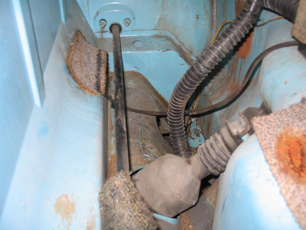

Have a close look at your tank where it meets that felt pad on the driver's side. That rust stain looks bad. On my car the felt pad was wet and lead to a rust hole the same size as the pad.
Inspect your tank and remove the felt pad and replace with rubber.

the exterior tank rust hasn't even pitted the surface. more of a stain. debris accumulated inbetween the spot on the tank and the pass side of the well. jack's car would idle and die or not start at all until after a few minutes of the pump running. air bubbles were evident while cranking. no filter was installed after the tank outlet and prior to the pump. the screen looked as tho it had folded over because of being plugged when under suction. show the old tank screen jack. clean it up and let's put the tank in.

Just took mine out last week! What a dirty mess... Would recommend asking the PO about the condition of the front fuel lines if buying a used 914--I was lucky I pulled mine because the dry-rot on the hoses caused an immediate leak...

You can use anything you find for the rubber pad. Cut a piece out of your "WELCOME" mat.

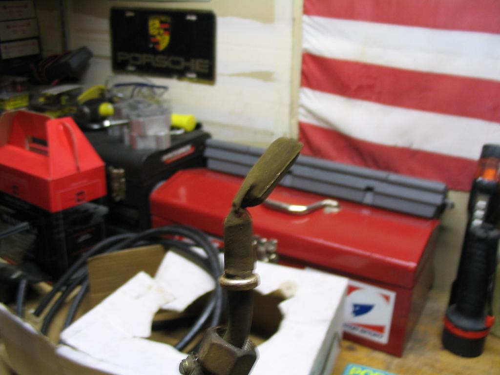

Here is a picture of the filter sock that came out of the tank. It has a tear at the bottom and you can see how it is collapsed. My thinking is that under suction it just sucks itself flat thus low or no fuel flow. We will see.

Okay--the replacement to the felt is right under my nose--cut up an old MOUSE PAD!
