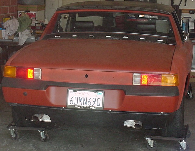

Well, took a couple of weeks off and travled up to Port Townsend WA and the WCR in Seattle...great times and good people. Was able to get some great ideas from all the neat cars. After riding in Jamie's Buick 914, I've decided I have too bump up the front brakes immediately! Dang...these little cars haul ass with some more horsepower.
Thanks to Jamie, I brought home the valance on his 74 roller. The holes for the dual exhaust lined up pretty good. I know have to decide whether to close up the hole for just one tip or change the tips to fill the hole. Perhaps dual tips, or one larger oblong tip...not sure at the moment.
Installed the Ghetty dash...tomorrow the gauges go in and if all goes well, I'm taking it around the block for it's maiden voyage.
It's licensed and insured now.....

computers4kids   A little more progress... I took...no, "I dro...   Aug 1 2008, 06:12 PM
computers4kids   After the muffler shop, drove it down to this high...   Aug 1 2008, 06:38 PM
JRust   Sounds good Mark! Dual tips fill it perfectly....   Aug 2 2008, 12:30 AM
