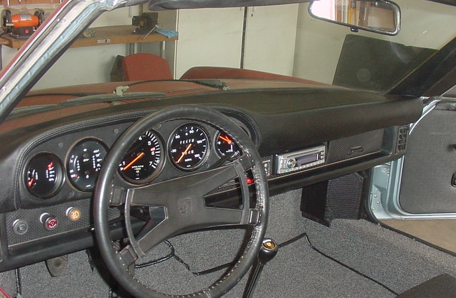

Installing the ghetty dash took much longer than I had expected. I took the time to lengthen the wires that needed to be using the correct colored wire from an old harness that I had been saving just for this. Added the rest of the wiring, like senders for the oil pressure, water temperature, voltmeter, clock and all the lights in the new gauges. I did not cut any of the wires of the 75 project car's dash so the whole dash is reversible if someone was so inclined.
It turned out looking pretty sharp! I have to give special thanks to Morphenspectra (james) for doing an outstanding job covering the dash in leather and of course, BigMark Deisgn for customizing a few of my gauges (added volt and water temp gauges and changed my v-8 tach to a non-silver bullet). I also took his advice and I wired a "fans on" lamp at the bottom of the tach to let me know when the fans come on.
And finally, I DROVE MY CAR TWO FEET TODAY (IMG:style_emoticons/default/av-943.gif) (IMG:style_emoticons/default/av-943.gif) I couldn't get the transmission into reverse to get out of the garage and it was late and I didn't want to start adjusting the linkage. If my memory serves me correctly, I should be able to adjust the shifter my moving it...I'll have to look up which way.
