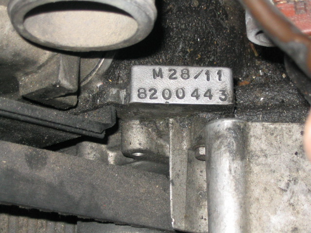

QUOTE(Joe Ricard @ Jan 5 2004, 03:21 PM)
Ok looked back at the spider intake YUP it is a EURO piece. What do you know about the engine? What is the number on the front rib by the oil fill? Euro motors put down 300 HP in CIS trim.
1980 Euro spec "S" 300 Hp. That is through restrictive exhaust, +30hp, pollition pump, air conditioning compressor, big cast alluminum fan, etc. OH YA! (IMG:style_emoticons/default/aktion035.gif) (IMG:style_emoticons/default/driving.gif)
