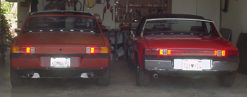

It's official...the 75 is off its rollers. I actually was able to drive it around the block a few times today. All I can say is "holy sh*@T" I am not driving this thing out of my neighborhood until I beef up the front brakes. This is going to be a fun ride.
On another note, I was suprised when I parked my 75 next to the 74, the 74 sat lower to the ground by about an inch both front and back...I expected quite the opposite and the 75 has lower profile tires (60's compared to the 65s on the 74).
Next step, build a GT grill...I think. Have to search the site for some "how to" write-ups.
