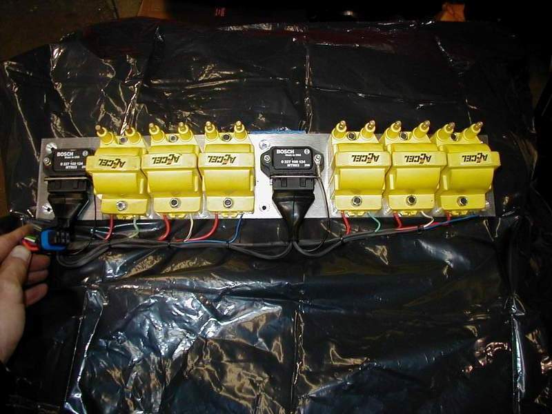

Dont want to hijack McMarks thread to much but here are some installs... We usually use Bosch 3 channel ignition modules..
3.7L Hi-output /6
coil board set up

TimT   Not so much that they are built into the system ...   Jul 22 2008, 07:01 PM

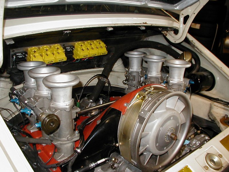

TimT   I happen to have the engine of my car out while I ...   Jul 22 2008, 07:08 PM
TimT   In this pic you can see the TPS, IAT, CAS, and if ...   Jul 22 2008, 07:09 PM
