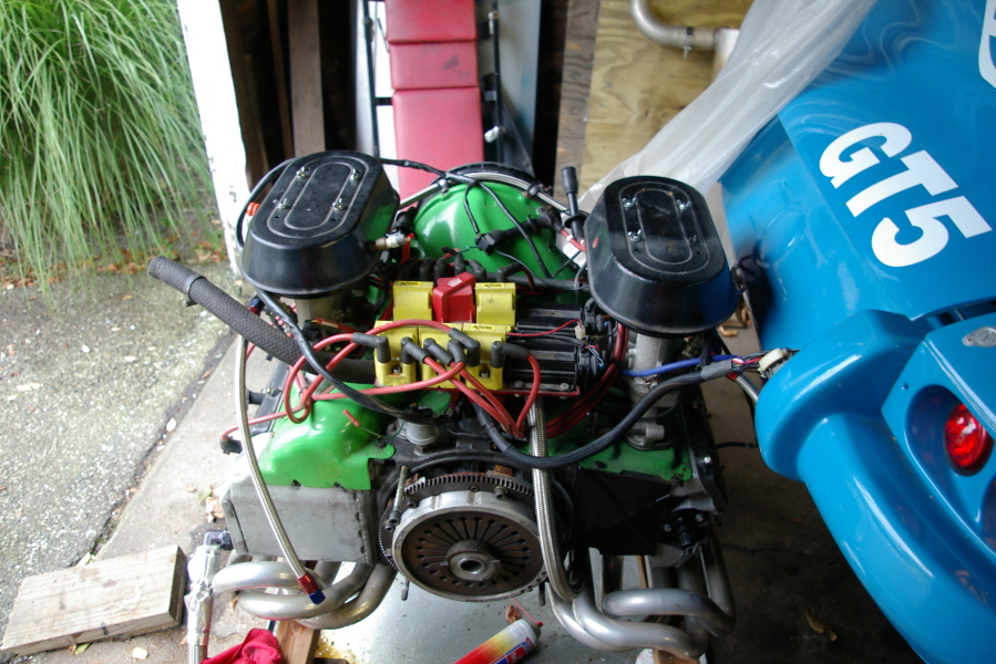

I happen to have the engine of my car out while I regear the transmission ( yet again (IMG:style_emoticons/default/dry.gif) )
I used a Link ECU and the ignition module they supplied... this was another EFI system test....and yes Link is a good system... especially the G3 ecus... but I digress.

TimT   I happen to have the engine of my car out while I ...   Jul 22 2008, 07:08 PM
TimT   In this pic you can see the TPS, IAT, CAS, and if ...   Jul 22 2008, 07:09 PM
