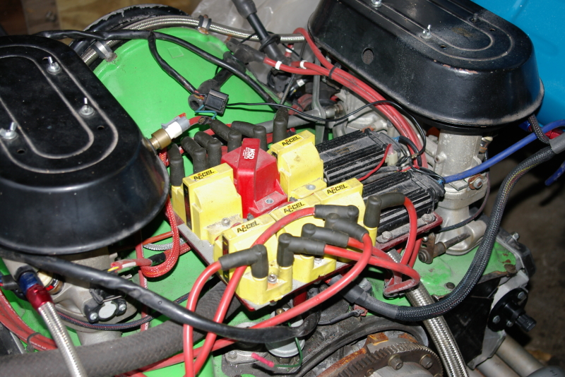

TimT
post Jul 22 2008, 07:09 PM
retired
Posts: 4,033
Joined: 18-February 03
From: Wantagh, NY
Member No.: 313
In this pic you can see the TPS, IAT, CAS, and if you look really hard the knock sensor
Sorry bout the hijack Mark (IMG:style_emoticons/default/beerchug.gif)

TimT   I happen to have the engine of my car out while I ...   Jul 22 2008, 07:08 PM
TimT   In this pic you can see the TPS, IAT, CAS, and if ...   Jul 22 2008, 07:09 PM
