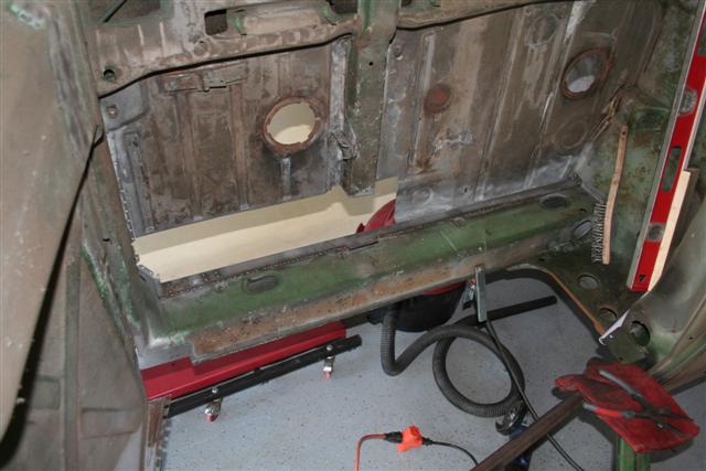

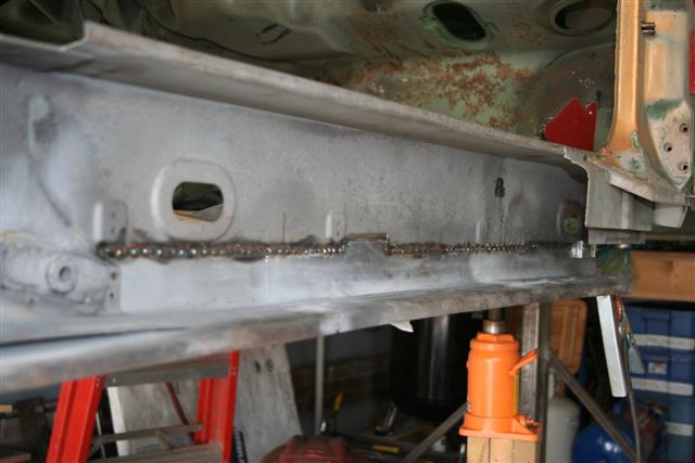

Made some progress last week. I had taken the week off for vacation and worked about four hours a day over five days. I made more progress than these pictures show...
Here the part I fabricated is welded in. When butt welding thin sheet metal, you have to do short welds and space them apart and let it cool. Rinse and repeat until you are done. You should alternate back and forth between front and back as when the weld cool they will pull the metal toward the weld. That will help cut down on warping.
With it welded in place the car is strong enough that I don't need to support it with jacks and can now rotate freely on the rotisserie. This also allows me to put this section level with the floor so I don't have to weld out of position.
