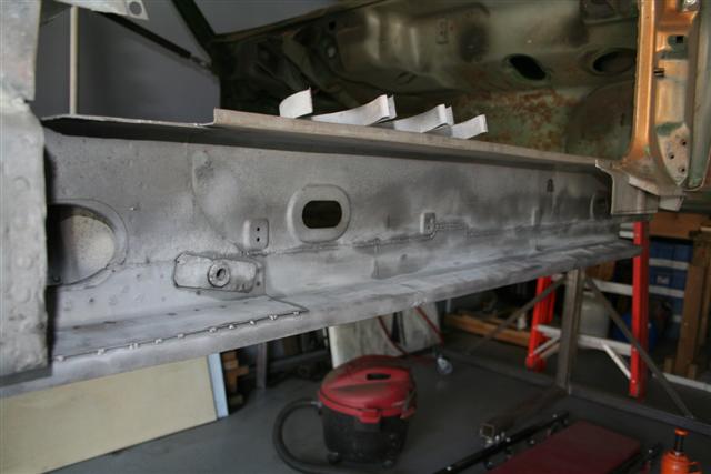

Close up of the rosette "spot welds" near the passenger seat belt anchor. Also you can see the unfinished but welds on the joining seam. Upper left is some welds in a previous butt weld that had some pinholes.
All done. I grinded down the butt weld on the interior all the way to achieve a smooth finish, but on the inside I didn't grind it down flush as there is no need. This will be hidden and I just dressed up the welds. I then lightly media blased the welds to remove all oxidation and then sprayed with Metal Ready. Metal Ready is great stuff.
